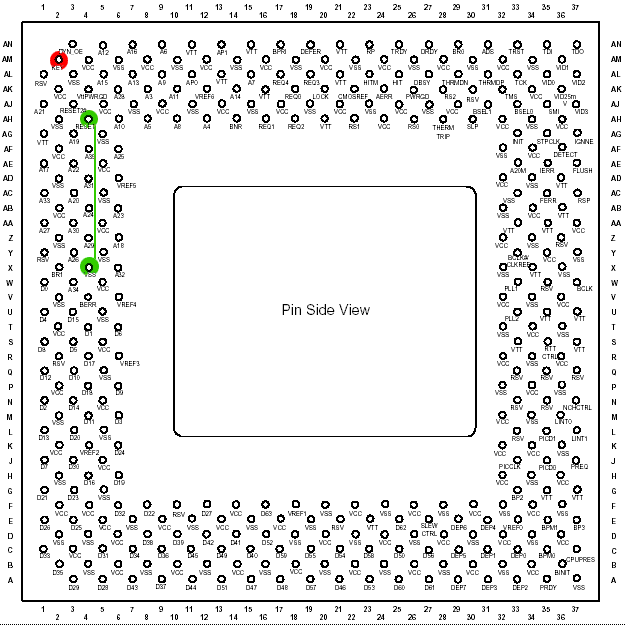

The main moments - numbering of lead-out of the processor.
Рис.1. Socket370 - нумерация, сигналы, вид со стороны ножек процессора.
I.e., to receive " correct arrangement " (for readout of number of a leg), is necessary to turn the processor (or a card / adapter) legs to itself (details downwards for a card / adapter), and two "cut off" corners (key) to arrange at the left. Then the left bottom corner will be the beginning (absent leg A1), on a vertical - letters from A up to AN, across - numbers from 1 up to 37.

For that that has earned processor with Coppermine nucleus in old PPGA a motherboard (adapter) it is necessary to make only two actions - to isolate a leg of processor AM2 (unsolder, to break out, etc.) and to connect the crosspiece of leg X4 and AH4 (to solder the crosspiece on a motherboard, an adapter or accurately to roll up a delay on the processor, that, the truth, is essentially more difficult).
Рис.2. Переделка PPGA в FCPGA.

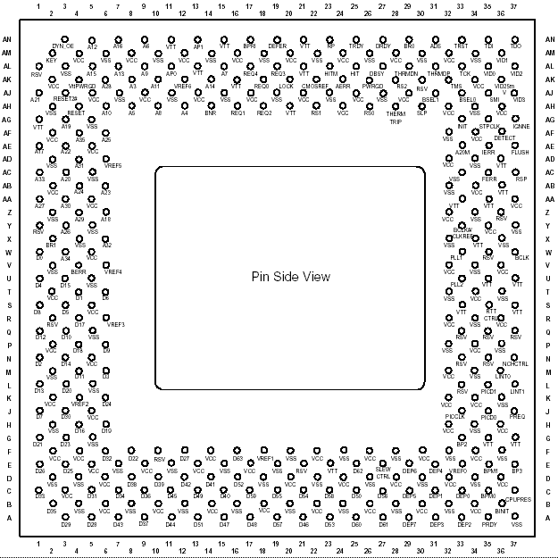

Case of the second, remaking of FCPGA-card/adapters for support of FCPGA2-processors Celeron and Pentium III on nucleus Tualatin.
In the given section, we shall consider the most simple case remaking under Tualatin processor - on FCPGA it is necessary to establish a card / adapter Tualatin, i.e. then other processors (for example, Coppermine) there will not be inserted. If there is a desire to receive " a universal socket " - see sections see section for "were interested" and "advanced".
So, for remaking it is necessary - to isolate pinout AJ3 and AN3 (unsolder from a socket, to break out on the processor to put on isolator, etc.), to short-circuit among themselves G35 and G37, and also AM34 and AK36/AL37 (see fig.).
Рис.3. Переделка FCPGA в FCPGA2.
Except for these simple actions there is one difficult moment - pinout AK4. She, on the one side, needs to be isolated from a socket, on the other side, to submit on her voltage Vtt (easier - from the nearest leg AN11). Here it is possible to act differently: accurately to drill contact AK4 and then to lead there the crosspiece from AN11, to put on on AK4 isolator, having inserted in him the crosspiece from AN11, etc. If not it is a pity the processor (or a leg already break;) it is possible to draw a track a special current-carrying pencil (or such as that). Here - business of imagination of everyone, the main thing - confidently to isolate AK4 from a socket (since "ground" there is initially dissolved, i.e. "0"), having submitted thus on him the necessary voltage (i.e. there should be "1").
